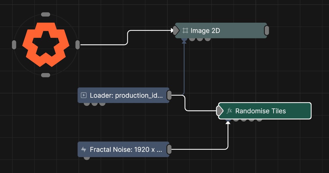

Randomise parts of the image based on an input image.
This node breaks the image into a grid, and randomises the positions and frame delays of parts of the image based on an input image.
The processed texture above has been altered from default to show the kind of effect you can get with this node. By default, no change will be made to the node until you input an image.

Show Offsets Visualise how the image is being offset based on the tile input.
Randomisation X ImageRandomise the image along the x axis based on the luminance values from an input image.Video Loader
Randomisation Y ImageRandomise the image along the y axis based on the luminance values from an input image.Video Loader
Delay Offset ImageRandomise the frame delay per tile based on the luminance values from an input image.Video Loader
