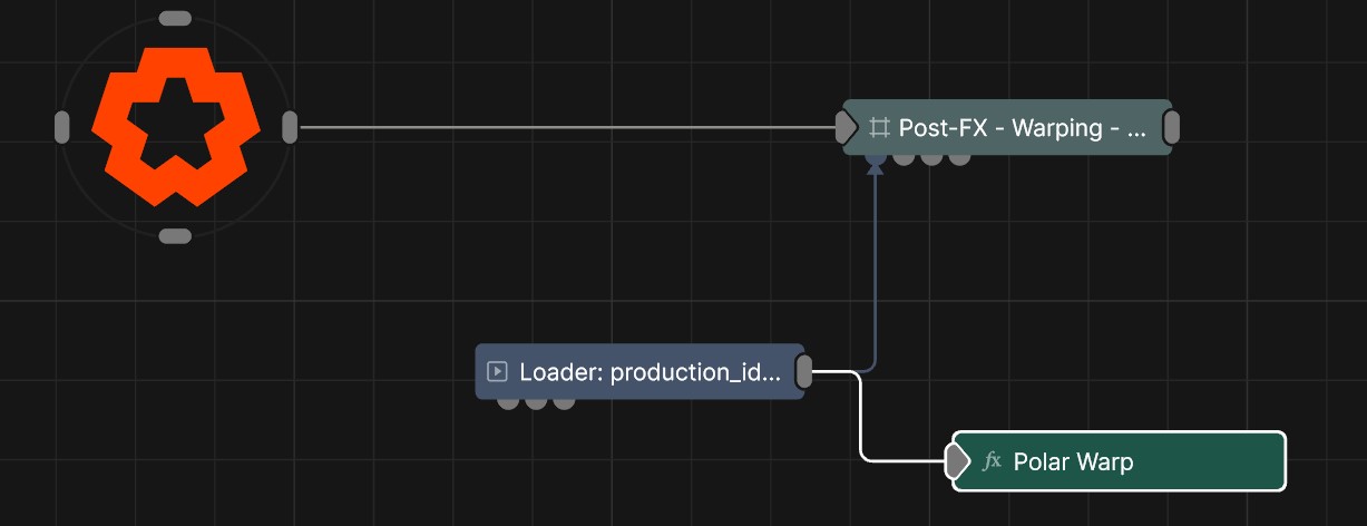

Warp the image using polar coordinates.
This node applies a warp to the image by using polar coordinates. The Tiles U/V parameters can be used to make the effect repeat.
