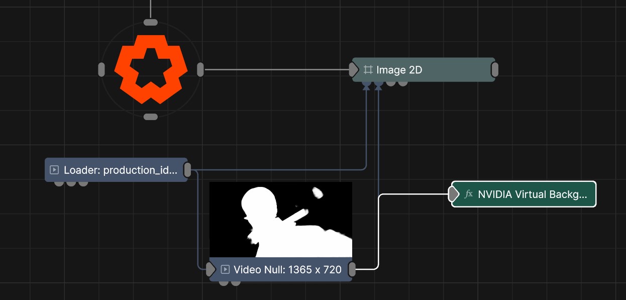

This node uses NVIDIA’s Virtual Background technology running on NVIDIA RTX enabled GPUs to pick out human forms in video / images and remove them from the background, outputting a greyscale mask. This eliminates the need for green screen keying, allowing for use in much broader contexts.
The background removal is achieved using AI and was primarily developed by NVIDIA for use on webcam feeds, for video calls, and streaming, so has been trained primarily on those data sources. It will give the best results on video feeds that resemble those - e.g. front shots of a person’s head + shoulders. However, it still achieves good results on a much wider range of scenarios. A 16:9 aspect ratio input feed at HD resolution is recommended for best results.
Do not multi-parent this node. Multi-parenting breaks internal frame-to-frame coherence, resulting in significantly lower performance and reduced quality.
If your project contains multiple Virtual Background nodes, they must all use the same Quality Mode option. Mismatched settings can lead to significantly reduced performance.
