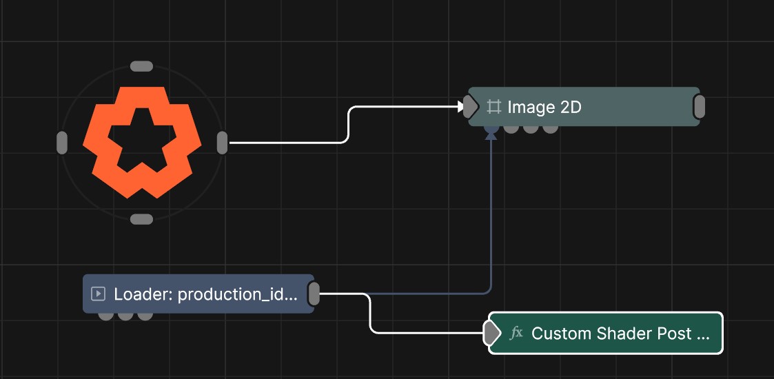

Add a custom .fx shader script as a Post-FX
This node allows you to write your own custom shaders for use as a Post FX within the Notch nodegraph. Notch shaders are written in HLSL and use the D3DX Effect framework which allows for multiple techniques and passes and access to all of the pipeline stages. For Post FX the Pixel Shader is most commonly used for processing and effecting images.
Use of custom shaders is at your own risk. 10bit does not provide support for custom shader code. If you experience an issue with a project/block you will need to demonstrate your issue without your custom shader in the nodegraph, to be able to receive support from the 10bit team.
Shaders are resources with a .fx suffix. The most effective workflow for authoring shaders is to import your shader resource and turn on Reflect Resource Changes (right-click resource to set this). Now every time you save your shader in your text editor, the shader will be reloaded in Notch.
Any compilation errors will be reflected in the log (View -> Log Window)

Once the updated shader code has been saved a “SecondInputBuffer” input pin will appear on the node, which you can then connect other image nodes to.
An example of a Post-FX shader is below:
