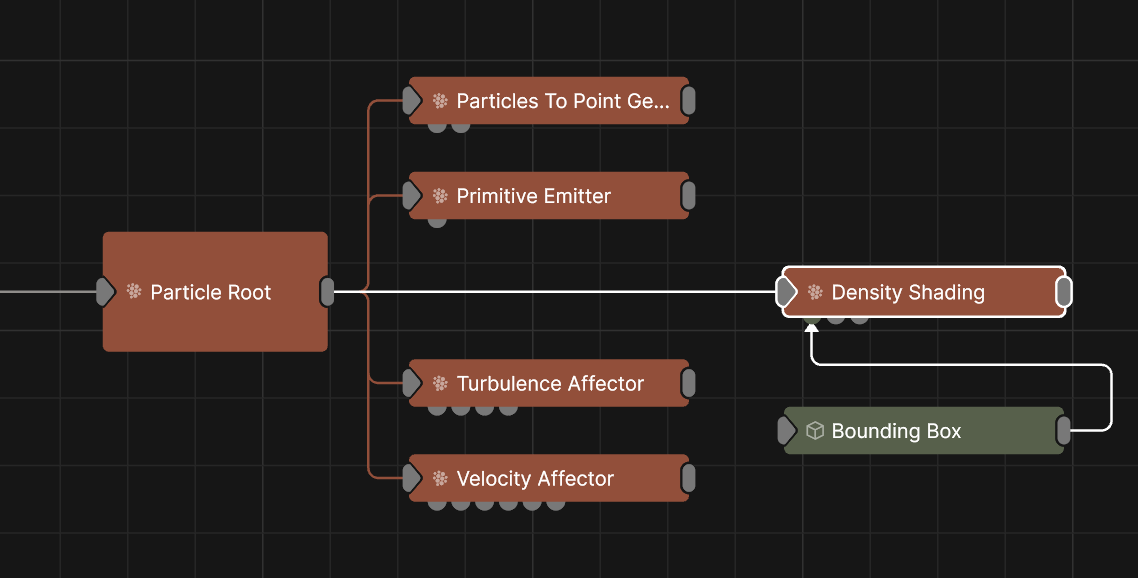

Shades particles by their density.
This node shades particles by the density of particles in a given area of space. More particles close together results in a brighter shading result. The node uses an internal bounding box to define the area of space that it considers, so you may need to add your own Bounding Box node to increase the area to sample. The area of space sampled per particle to determine density depends on a bounding area: it is segmented discretely, so a larger bounding box will cause a larger area per particle to be tested.

Bounds NodeThe bounding box of the space considered by the node.Bounding Box
