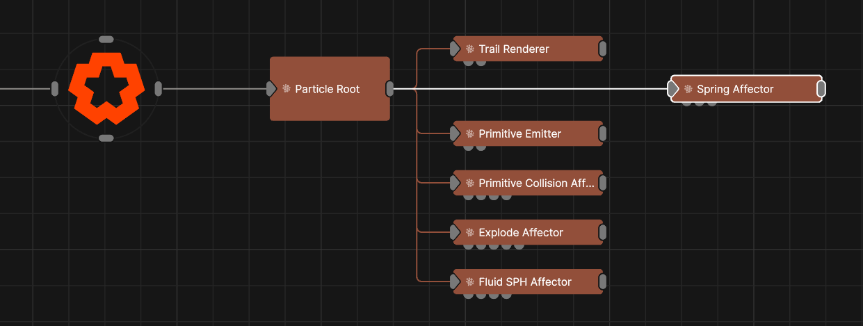

Applies a spring simulation on particles.
This node simulates a spring-like effect between a particle’s current position and its original emission position, making it spring back towards the point it was emitted from over a period of time. This can be used to restore particles to their original emitted form, or as part of cloth simulations.
Spring Length The scaling applied to the rest length of the generated springs.
Spring Strength The strength of the spring effect. Larger values will make spring forces greater and particles will move more quickly.
Spring Dampening The dampening applied to the spring forces.
