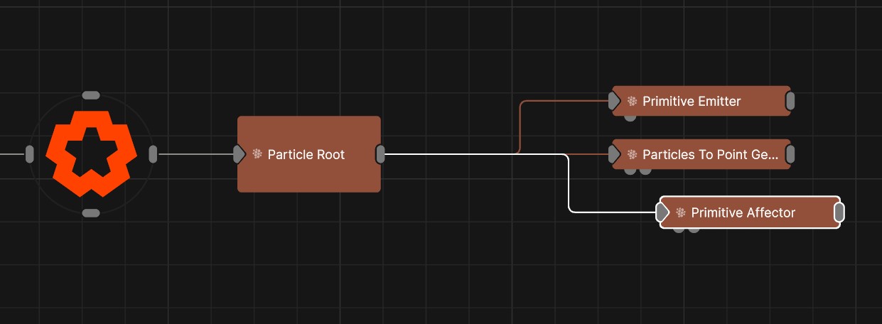

Apply forces to particles from primitive shapes.
This node is used to attract or repel particles from the surface of the selected primitive type. This is typically used to make particles form into a given shape. Particles will use the closest point on the primitive’s surface to move towards or away from; this may be offset randomly using the Randomness attribute to create a noisier shape.
