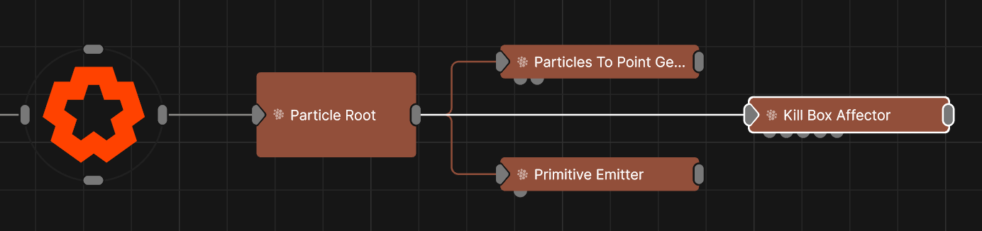

Remove particles from inside or outside a zone.
This node kills particles that are either inside or outside of a bounding box, dependent on the Kill Mode attribute. Particles can be killed immediately or decayed over a period of time depending on the Kill Operation.
Kill Mode Toggle whether particles are killed inside or outside the area.
Kill Operation Choose how the particles are killed, instantly or slowly.
  • Kill : Instantly kill particles.
  • Decay : Fade particles out over time..
Decay Rate Rate at which particles fade out when “Kill Operation” is set to “Decay”.
Particle Kill Amount What percentage of the particles should be killed.
Box NodeSpecifies a bounding box node to be used for the kill box.Bounding Box
Procedural NodeUse a procedural system as the shape of the kill box.Procedural Root
