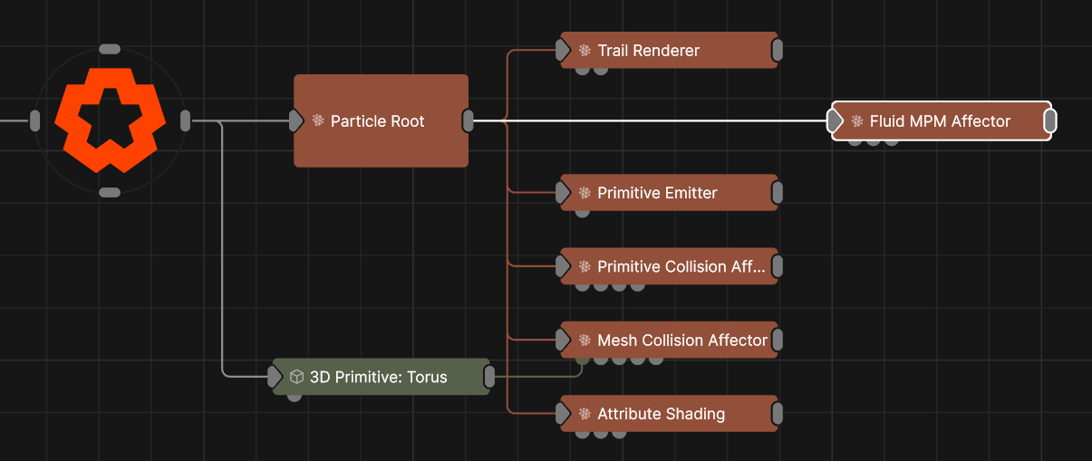

Simulates fluid dynamics on Particles with an MLS-MPM simulation.
This node applies a fluid simulation using a variant of the MLS-MPM (Moving Least Squares - Material Point Method) fluid solver. This fluid simulation method can generate faster and more stable fluid simulations than other methods, while also highly detailed, better at settling over time, and maintains volume throughout. Best used for water simulations, not designed for high viscosity lquids (e.g, toothpaste).
The MPM simulation is an adaptive voxel based method, meaning the fluid is broken up into a grid cells which run the fluid sim, and the simulation is only calculated for the cells which contain particles. This means the sim is generally efficient, but it can be slower if every cell has a particle in it.
