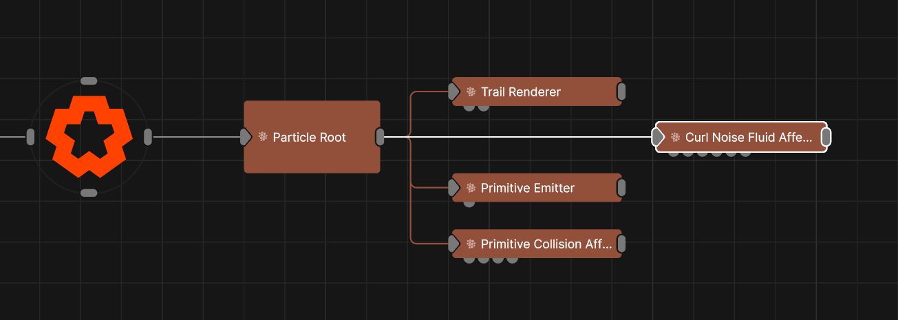

Applies curl noise velocities to Particles.
This node gives the affected particles a fluid-like motion. This is typically used to make particles move in a turbulent but spatially coherent manner with local eddies like smoke or liquid. The motion is generated procedurally using Curl Noise rather than simulated so it doesn’t incur the performance overhead of a fluid solver.
The effect is weighted by a falloff calculated using the distance from the node to the particle, ramping from 100% at distance zero down to 0% at the distance specified by the Radius attribute.
Fluid Simulation Speed Speed at which the fluid simulation updates.
Curl Noise Amount Controls the magnitude of the motion applied to the particles.
Noise Size Controls the size of the noise curls.
Normalise Noise Parameters Automatically balance the curl noise amount when the noise size changes.
Velocity TransformCan be used to apply an additional transform to the velocities generated by the node.Null
