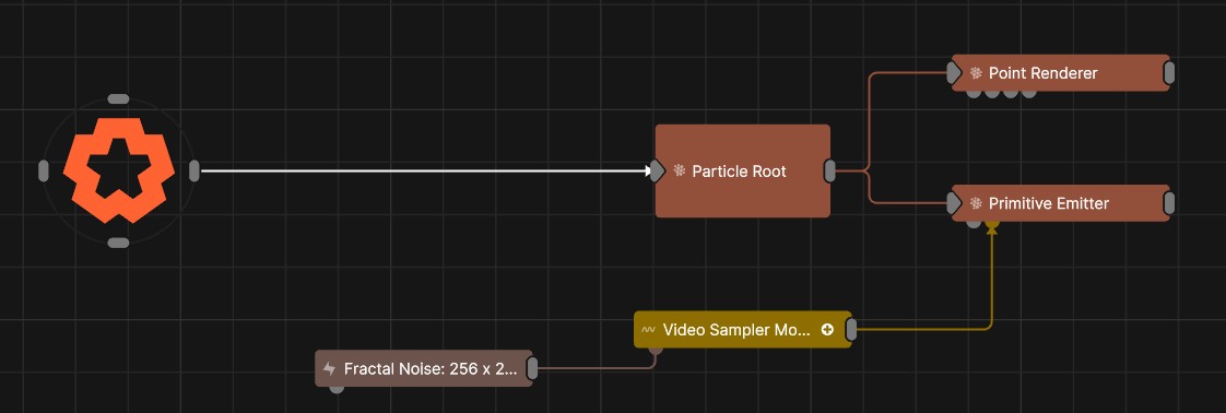

Samples a video to generates a modifier value.
This node outputs a modifier value based on the RGBA values of pixels from a video input. You can either sample a single spot, or sample an area with the Sample Rectangular Area Parameter.
The response of the modifier can be tuned to a single band of colour using the weighting attributes.
