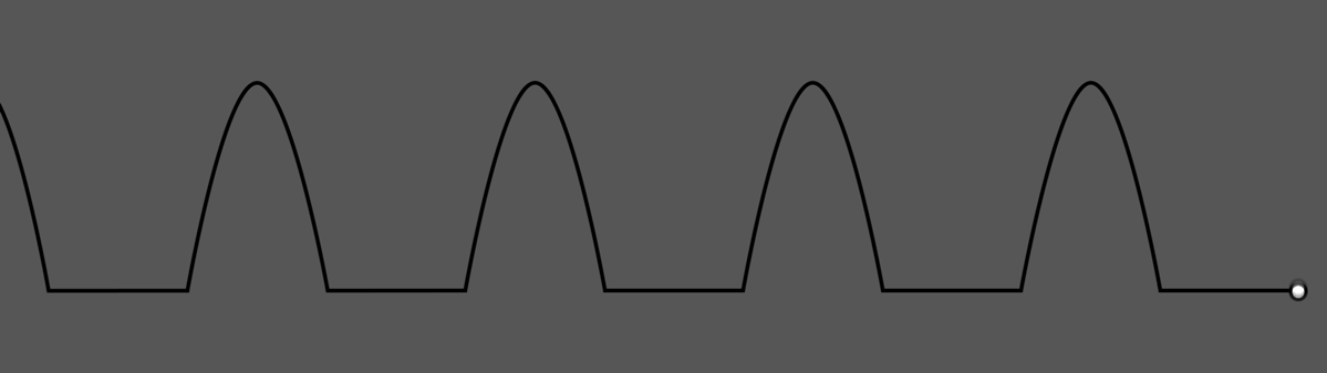

Limit and remap the incoming modifier value.
This node limits the range of values that can be output and linearly remaps incoming values to fit within the output ranges.
For other methods to remap a value non-linearly, you can use the Expression Modifier
Value Base value to modify the output value with.
Modifier Operation The operation to be performed on the targeted parameter.
These properties control the incoming data range. Values outside this range will be clamped.
In Lower Lowest value in that will be remapped into range.
In Upper Highest value in that will be remapped into range.
These properties control the outgoing data range.
Out Lower Lowest value that can be output.
Out Upper Highest value that can be output.
