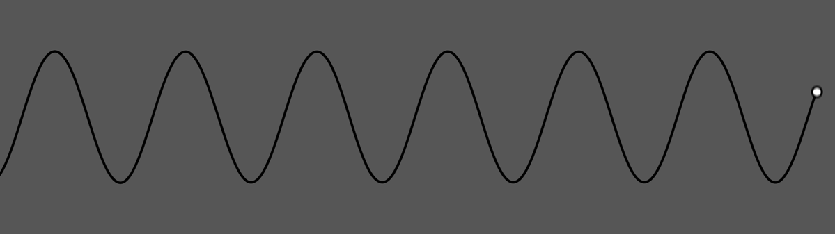

This node generates modifier values on the basis of mathematical pattern functions, from smooth sine waves to noise. A speed value of “1” equals one whole cycle taking 1 second, or 1 Hz if you will. The exception is the various noise functions that generate random values for every frame.
The node provides a preview of the pattern value that will be generated with a tracer line showing the place of the play head.
