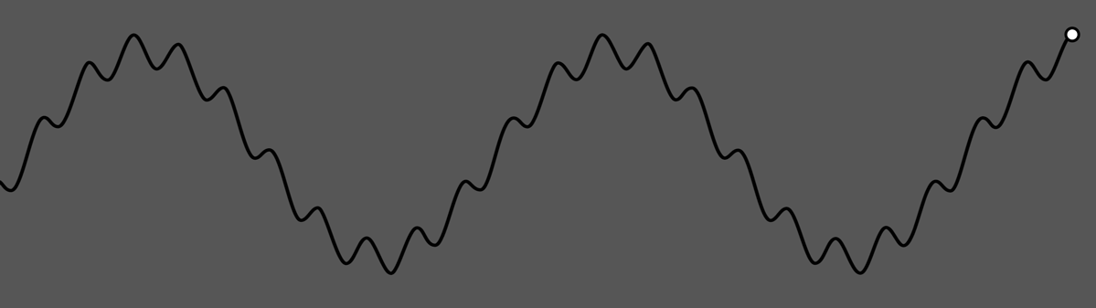

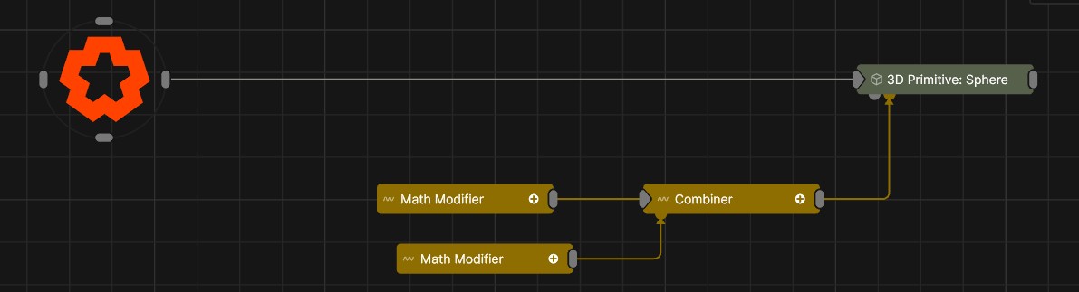

Combine two modifier values with basic math operations.
This node combines two modifier inputs to create a new modifier output, using basic math operations. For more complicated operations, use the Expression Modifier.
Value 1 The first input value
Value 2 The second input value
Combiner Operation How the two inputs are to be combined:
