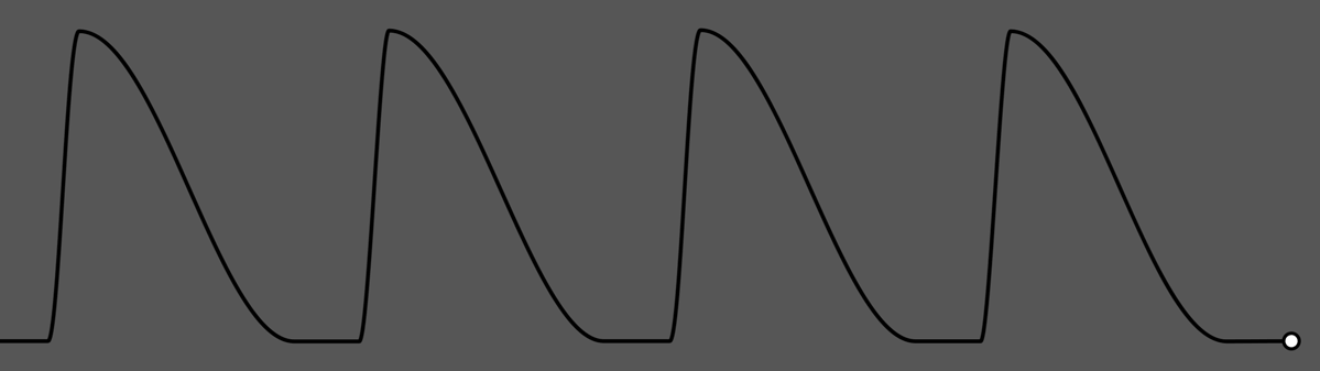

Generate a modifier value based on a consistent BPM.
This node outputs a cycling value based on a consistent BPM. The Speed, shape, and magnitude of the pulse can all be altered by altering the nodes properties.

BPM Beats per minute, or how many times the modifier will reach its peak per minute.
Num Beats Number of beats per BPM.
Num Beats Offset Offset the beat timing of the Num beats.
Time Offset Offsets the time the value is modified from the time the waveform is played.
Attack Controls the initial time between the current value to the peak.
Pulse Sharpness How sharply the pulse eases into its peak value.
