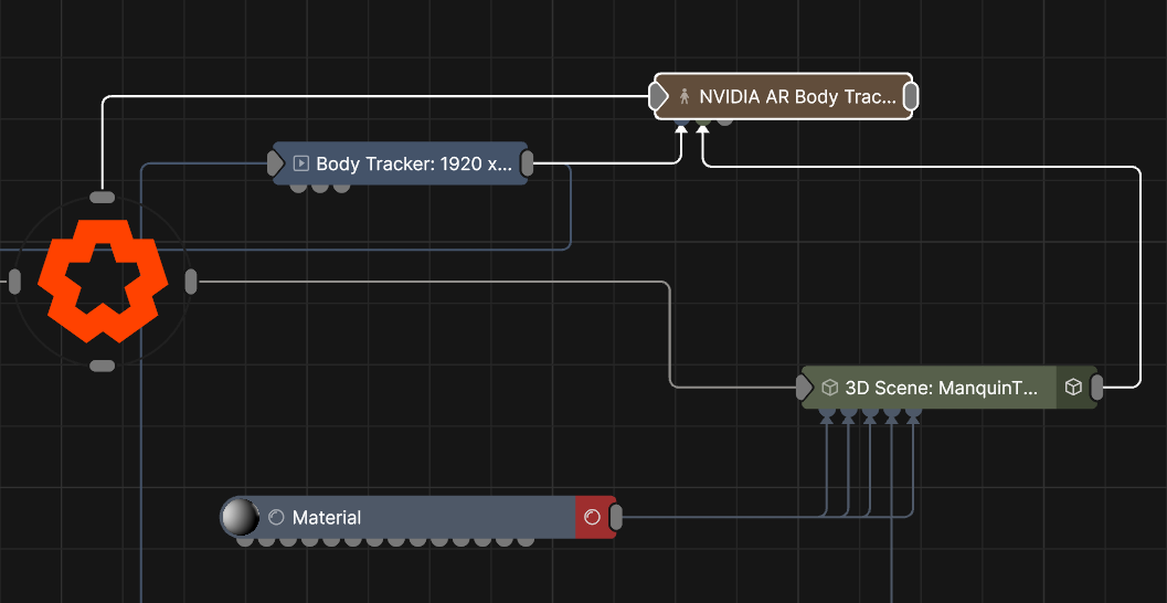

NVIDIA AR Body TrackerRequired body tracker input, for generating a tracked skeletonNVIDIA AR Body Tracker
Hierarchy RootConnect the skeleton root node to drive the rest of the skeleton from.3D Scene
