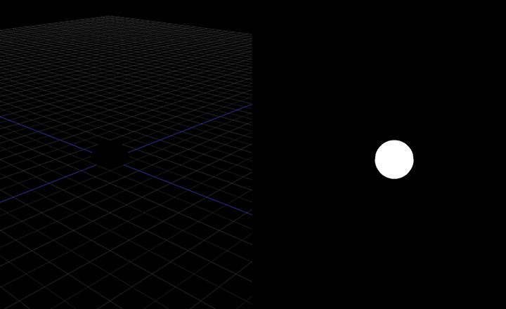

In a Notch scene, nodes are assigned to the Render Layer that parents them - either directly or indirectly - through the hierarchy. If they are not parented to a Render Layer they are assigned to the Root Node - which is a Render Layer in itself. When the Select Render Layer For Child Nodes node is inserted in the hierarchy, its direct or indirect children will instead by assigned to the Render Layer linked to the “Render Layer” input - as long as the node is enabled and the “Active” Parameter is set to 1. If the node is disabled or the Active parameter is set to 0, the behaviour reverts to assigning the children to the parenting Render Layer in the hierarchy.
The distance from each child geometry node to the currently active camera can also be used as a condition, if the “Camera Clip Plane Mode” is set to In Front or Behind. The selection is done via the bounding box of each geometry node. A bounding box can also be used to control the selection when linked to the “Bounds” input.
