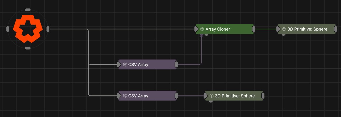

This reads an array of transforms from a table resource. The array is used to create instances of any nodes attached to the subtree of this node - so the subtree / children are re-rendered for every transform in the array. The number of elements in the array will match the number of rows (Table) or items (Flat list) in the table.
See the Array Sources node to see how this node is used in the nodegraph to multi-instance child nodes.

The output transform array may be used directly with a Array Cloner, or to clone other nodes within a Field System or Particle System.
