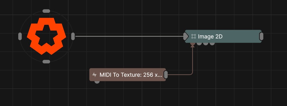

Generates a texture based on a connected MIDI Keyboard.
This node generates a texture based on the output from a connected MIDI Device. Useful for visualising the inputs of a MIDI Keyboard, with standard attack/decay controls.
