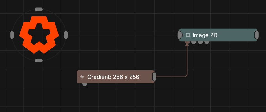

Generates a gradient image.
This node generates a gradient texture, with various modes and modifying properties.
Mode How the gradient is generated.
  • Linear : the gradient moves outward from a line.
  • Radial : the gradient moves outward from a point.
  • Linear Clamped : The gradient moves outward in one direction from a line.
  • Angular : The gradient moves radially around a point.
  • Linear (X Axis) : The gradient progresses linearly along the x axis.
  • Linear (Y Axis) : The gradient progresses linearly along the y axis.
  • Square : The gradient follows the outside of a square, with sharp edges.
  • Rounded Square : The gradient follows the outside of a rounded square, with rounded edges.
Inverted Invert the direction of the gradient.
Inner Range Change the point the gradient starts internally.
Outer Range Change the point the gradient ends at the gradient edge.
Falloff Power The falloff power of the gradient.
