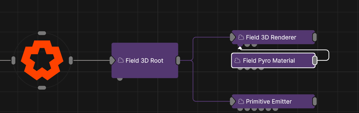

A 3D field material suitable for pyro / explosions.
A 3D field material suitable for pyro / explosions. The field density is used to control absorption and scattering, and the temperature of the field is used via black body simulation to output an emissive colour. The Scattering parameter is used to control the ratio of scattering vs absorption.
Tint Colour Tints the field.
Density Scales the density of the field.
Scattering Colour Controls the ratio of scattering vs absorption per colour channel.
Scattering The ratio of scattering vs absorption.
Temperature Limits If enabled, the temperature min and max values are used. otherwise the values from the field 3d root are used.
  • Use root temperature : Conform to the temperature limits set by the root.
  • Override : Override the root temperature limits.
Flame Emissiveness Scales the emissive output.
Min Flame Temperature The threshold above which the temperature contributes emissiveness.
Min Temperature (K) The minimum temperature of the field for black body simulation, in degrees kelvin.
Min Temperature (K) The maximum temperature of the field for black body simulation, in degrees kelvin.
Density NodesShading node input for controlling the overall density of the field system.Fractal Noise
Colour NodesShading node input for controlling the overall colour of the field system.Fractal Noise
Emissive Colour NodesShading node input for controlling the overall emissive colour of the field system.Fractal Noise
Flame Colour RampColour ramp input to control the colour of the pyro material.Colour Ramp
