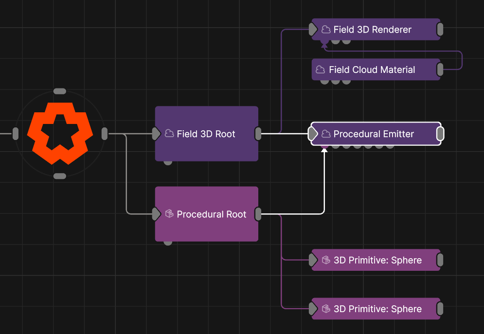

Emits ink into a field from procedurals.
This node emits colour/ink into a field using a procedural system.
A Procedural root must be connected to the Procedural Root input with a valid procedural generated for this node to emit anything.

Procedural RootConnect a source procedural system to generate the field. A procedural node must be connected for this node to function.Procedural Root
Bounding BoxLimits the area that the procedural emitter will use.Bounding Box
