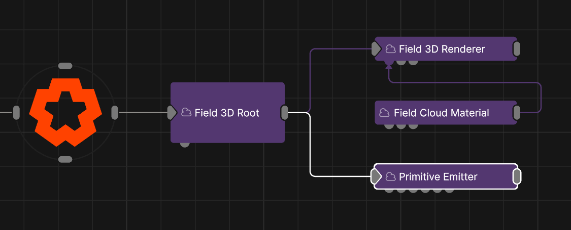

Emits ink into a field using a primitive shape.
This node emits colour/ink into the field using the volume of a primitive shape.
