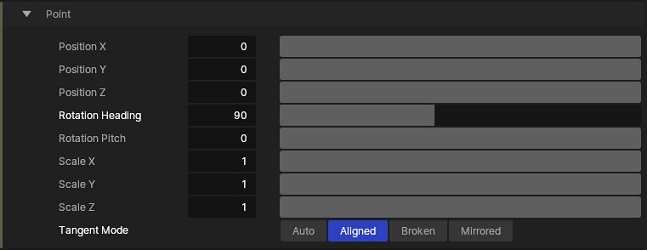

When you have a single spline point selected, spline point properties for that point are shown in the property editor to fine tweak the position, rotation and scale of the spline shape and its attached geometry nodes.
selectedpropsimage image
Spline points have a number of interpolation modes:
  • ‘Auto’, this mode automatically create a ‘best fit’ spline interpolation according to the spatial position of spline points, best for creating smooth spline shapes and loops interpolationautoimage image
  • ‘Aligned’, this mode has both incoming and outgoing editable tangents, the incoming and outgoing tangents are co-linear but can have different scaling making it more controllable than ‘auto’interpolation mode interpolationalignedimage image
  • ‘Broken’, this mode is the most configurable of the point interpolation modes allowing incoming and outgoing tangents to have different directions and scales, you can use this to create sharp curves or corners interpolationbrokenimage image
  • ‘Mirrored’, this mode has incoming and outgoing tangents which are co-linear like ‘Aligned’ interpolation mode but the incoming and outgoing tangents have the same uniform scale interpolationmirroredimage image
Using a configuration of different spline point interpolation types per spline point allows for a fully customisable spline shape.

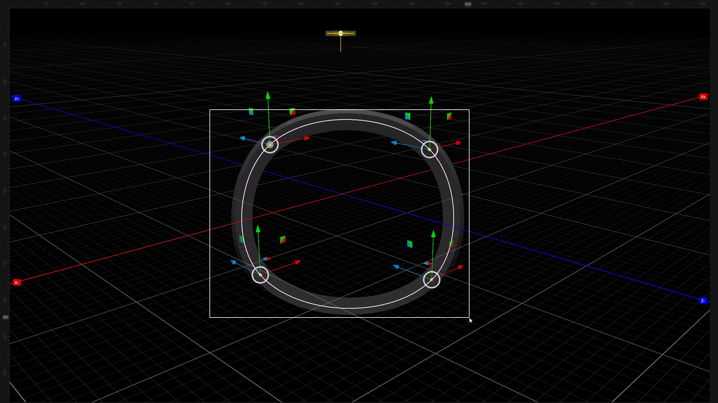

You can select multiple points in the viewport by:
  • holding SHIFT down and LMB clicking points to select or deselect points
  • When ‘Tangent’ ‘Add Point Direction’ mode is selected you can lasso points in the viewport with a LMB click drag
  • When ‘Tangent’ ‘Add Point Direction’ mode is selected you can add or remove from the selection by holding down SHIFT and lasso points in the viewport with a LMB click drag
  • When ‘Paint’ “Add Point Direction” mode is selected you can lasso points in the viewport by holding CTRL down then a LMB click drag
  • When ‘Paint’ ‘Add Point Direction’ mode is selected you can add or remove from the selection by holding down CTRL and SHIFT and lasso points in the viewport with a LMB click drag multiselectlassoimage image
  • Transformation modes supported for multi selection of points are; Translation, XY scaling and placement.

These properties control the individual point attributes.
Position X X position of the point.
Position Y Y position of the point.
Position Z Z position of the point.
Rotation Heading Rotation heading of the point.
Rotation Pitch Rotation Pitch of the point.
Scale X X scale of the point.
Scale Y Y scale of the point.
Scale Z Z scale of the point.
Tangent Mode Control how the spline tangents are generated for the spline.
  • Auto : Automatically generate tangents based on the preceding and following point.
  • Aligned : Both tangents will point away from each other but may not have the same length.
  • Broken : Each tangent will be controlled individually with no regard for the other.
  • Mirrored : Both tangents will point away from each other and have the same length.
