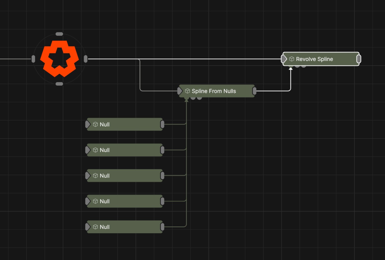

Revolve a spline to form a mesh
This node generates a mesh from an input spline curve, by following the path the spline would draw when rotated around a central axis. Useful for making Vases, Bowls, and other objects which are rotationally symmetrical.
A mesh can be used as input if it has the Object To Lines deformer. The Duplicate Spline deformer can also be used to easily draw multiple splines.
This node outputs the normal transformation and translation values, but it also outputs geometry which can be modified with Deformer nodes, or used as a mesh sources for nodes which accept mesh connections, such as the Field 3D Object Emitter or the Procedural 3D Object.
