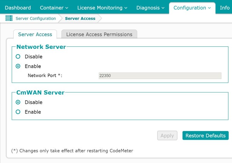

On the server:
  1. Download and install CodeMeter User Runtime for Windows
  2. Open ‘CodeMeter Control Center’
    1. Go to: File->WebAdmin
    2. In the Web Interface go to the menu: Configuration -> Server -> Server Access
    3. Enable ‘Network Server’ and keep the default port 22350
    4. Click Apply serversetup
Please note this will enable LAN connections (TCP connections to 22350). Please ensure that your firewall is allowing TCP access to this port on the License Server.
