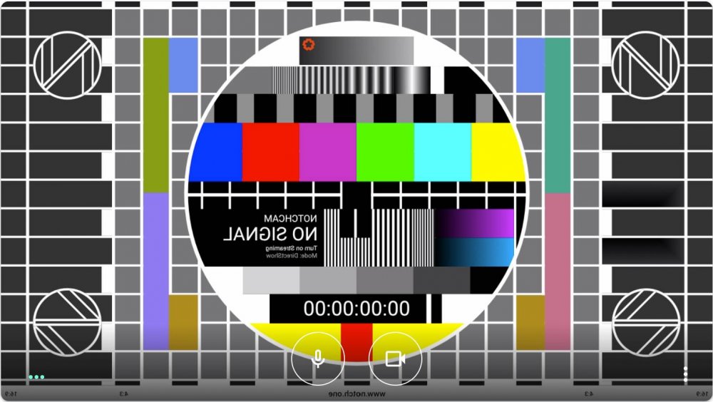

If you attempt to use the NotchCam in your 3rd party app prior to outputting from Notch Builder you’ll see a pre-transmission test image.
Pre-transmission preview from Google Meet being horizontally flipped.

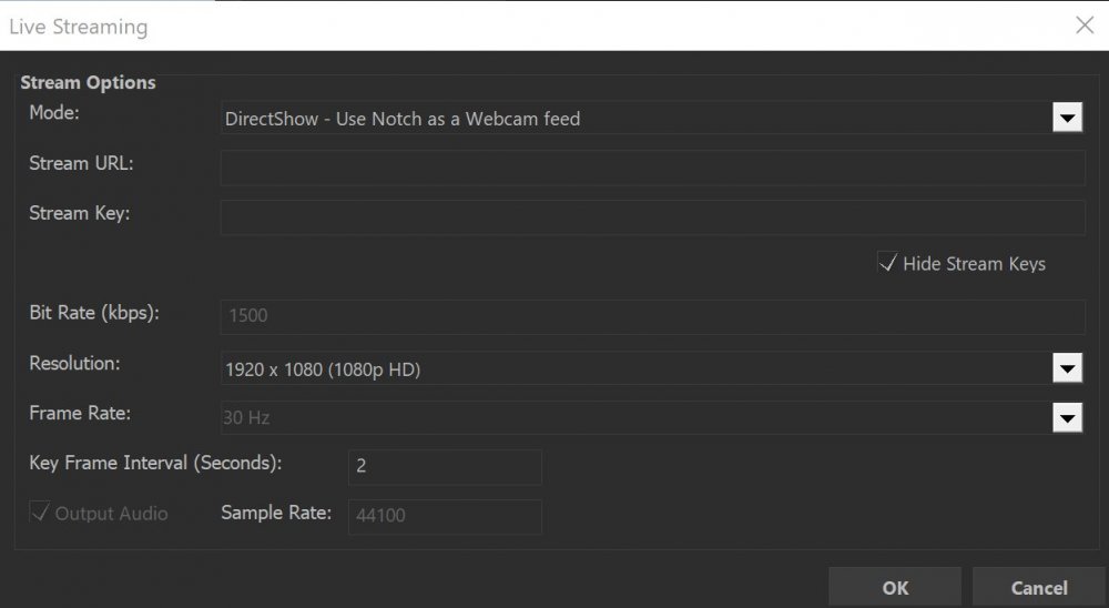

To output Notch Builder to the NotchCam:
  1. Menu Devices > Streaming
    1. Set Mode: NotchCam - Use Notch as a Directshow/webcam feed
    2. Select the Resolution you wish to present at
    3. Click OK, Your project will be automatically resized to the resolution that you have defined for your stream.
  2. Press Play
  3. To stop outputting to the NotchCam, go to menu Devices > End Streaming.
Streaming settings for DirectShow.
If you change the NotchCam resolution while your third party application is running, you may have to reselect the NotchCam in that application (or occasionally even restart it) so that it registers the changed resolution. This can usually be achieved by switching to another camera and then back to the NotchCam.
Many applications (e.g. Zoom / Google Meet) will preview your stream back to you horizontally mirrored. However, the end feed presented to other conference attendees will be the right way round.
