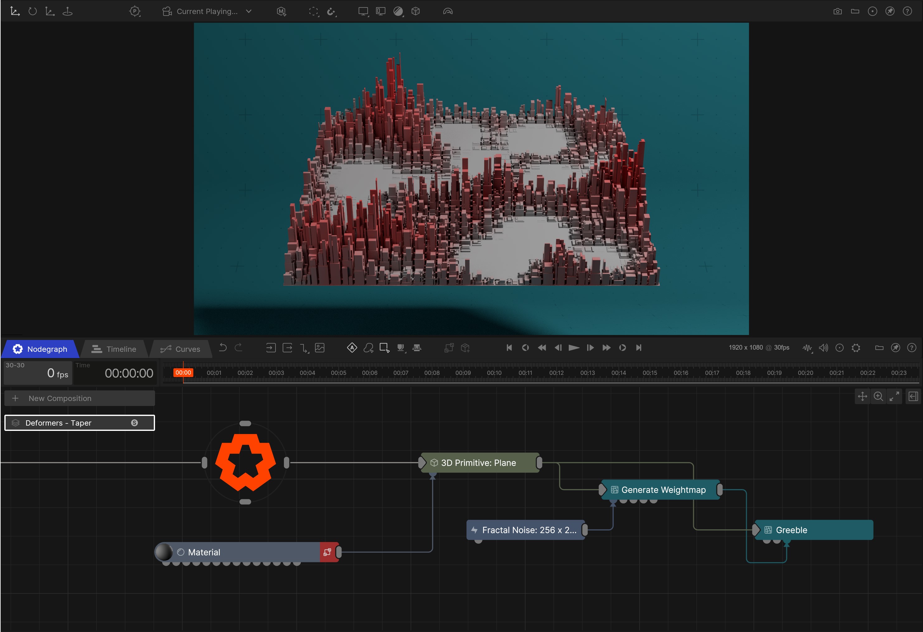

Deformers are the main geometry modification tools in Builder. Any node which generates a Mesh, Spline, Line or Point, can have Deformers applied to them and the affects generated.
Setup #
All Deformers can be applied to any node which generates Geometry by connecting it as a child to that node. Deformers are designed to be used together, and use a hierarchical workflow where nodes with a shared parent will be processed based on position in the Nodegraph (top to bottom, left to right). By re-arranging the order in which nodes are processed, you can change the resulting effect on the geometry.

These nodes control where other deformers are effective using per vertex or per polygon weightmaps. These can be connected to any Generated Weightmap input, to focus the areas the deformer affects the geometry. Some nodes, such as the Particle Mesh Emitter, can also use a weightmap to affect how they use the geometry, such as spawning more particles in weighted areas.
You can preview the weightmaps effect on the mesh using the preview weightmap option in the Property Editor.
Weightmaps, like all other nodes in Notch, are processed based on their position in the Nodegraph. So make sure to place your weightmap nodes above the deformers they will apply to, and be mindful of the deformer stack you are creating.
