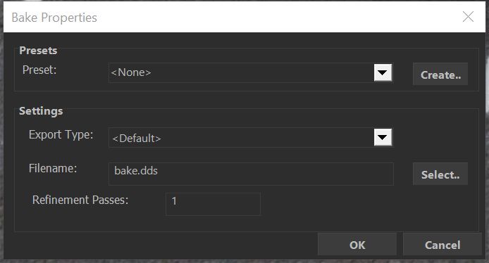

Hit the Bake Now.. button, this will open the bake properties dialogue box. Set the number of refinement passes that you want on the lightmap the more set the higher the build time and the more refined the lightmap texture. 10 refinements is a good way to preview the lightmap, 500 refinements will take longer but the lightmap will be better quality.
bakeproperties

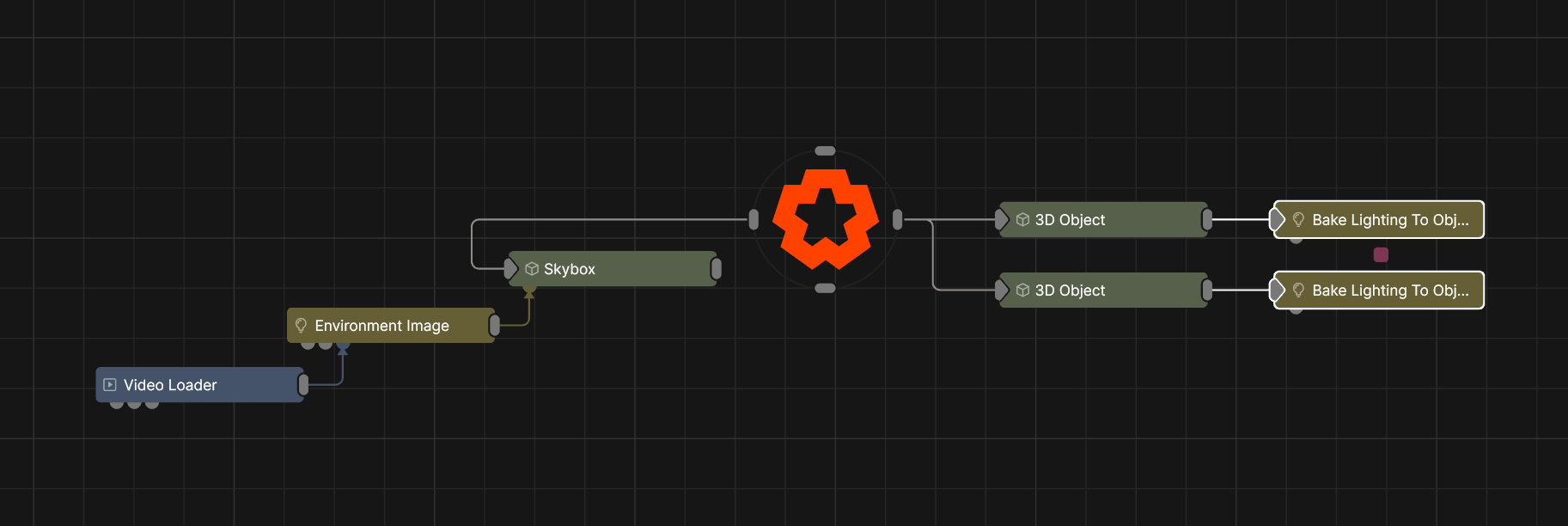

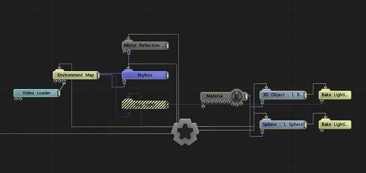

Example Nodegraph before bake #
bakedlightingnodesbefore
Once the lighting has been baked you can turn off the baked lights.
Example Nodegraph after bake #
bakedlightingnodesafter

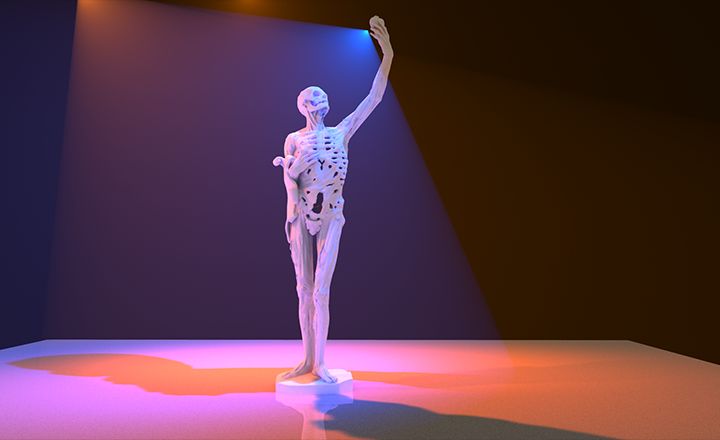

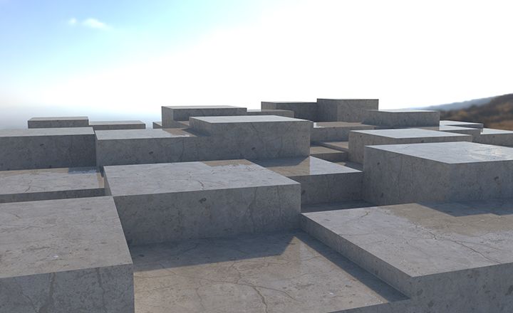

Baked Skylight #
bakedlightingskylightexterior
Baked Spotlights #
bakedlightingspotlights

Bake Now Opens the “Bake Properties” dialogue box.
Filename Append Add an extra string to append onto the end of the filename, allowing for multiple bakes to be done for a single node without destroying the previous bake.
Num Refine Iterations Set the number of refinement iterations per bake lighting node.

These are the properties available in the Bake Now option.
Preset Use custom preset values to generate lightmap.
Export Type This is set to a default texture type.
Filename Sets filename and location of the lightmap texture.
Refinement passes This sets the number of refinement passes on each texture, the higher the number of passes the better the fidelity of the lightmap texture (set between 10 Quick pass - 500 high quality)
