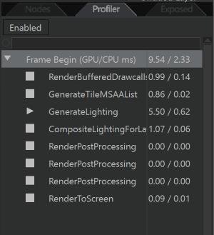

If you would like more details on what aspects of the scene are taking the GPU time you can use the Notch Profiler
  1. In the Nodes/Profiler/Exposed panel (usually bottom right), select Profiler
    1. Click Enabled (turns white)
  2. Play your project
  3. Observe the Profiler pane. The Frame Begin represents the total frame time – The left value is the GPU, right is CPU.
profiler
The profiler also allows you to see what aspects of the Notch render pipeline are taking time, to allow you to make some educated decisions.
With this information, plus an understanding of the GPU time taken by the Media Server, you have a total picture of GPU usage.
