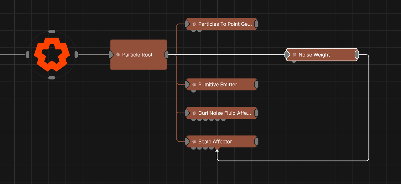

Generates weight values using noise functions.
Generates weight values using noise functions. These can then be used to vary the strength of affectors on the parent particle system.
The output from this node are particle weights which are unique to the parent particle system, so can’t be used to influence other particle systems.
