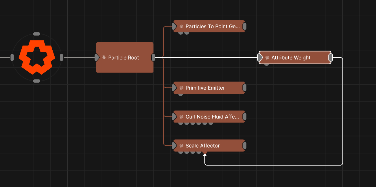

Generates weight values using attributes of the particle, such as its velocity.
This node generates a per-particle weight values using attributes from the parent particle system. These can then be used to vary the strength of affectors on the parent particle system.
The output from this node are particle weights which are unique to the parent particle system, so can’t be used to influence other particle systems.
