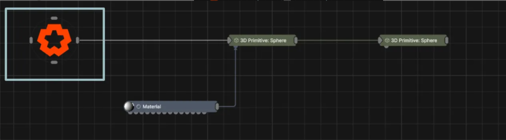

Node Connections #

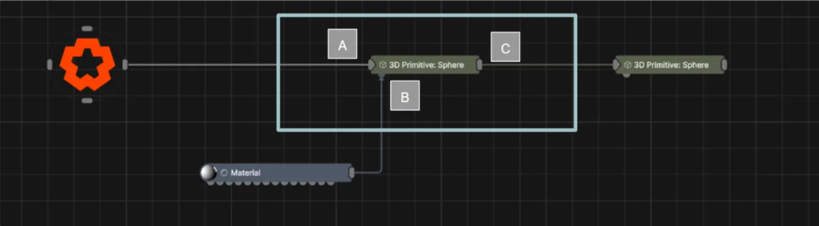

Each node has several pins. These pins can be used to connect different nodes together, by clicking on a pin of one node and then dragging to a pin of another node. There are three different types of pins on a node, for example on this 3D Primitive there is:
  • A: The parent pin. This will create a parent/child node between two nodes, and in some cases create some type of input. For example, the second 3D primitive in this image and, by default, will move with the first 3D primitive.
  • B: Input pins. These pins can be used to give an input to any given node, without creating a hierarchical relationship. For example, to apply a material to a 3D object. As you hover your mouse over one of these input pins, you will see a hint showing what the input is used for.
  • C: Output pins. These pins can be used to make other nodes a child of a given node.

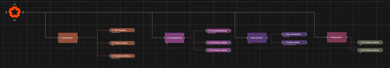

System Root Nodes #
Similarly, there are other root nodes that are needed for certain systems. Particle, Procedural, Field, and Physics systems all require their own root node. These system root nodes serve two purposes.
  • They give you access to all of the overarching properties of that system inside of the property editor.
  • They allow you to introduce other nodes to these systems. In terms of hierarchy a system root mode must be used above the other nodes that belong to these systems.

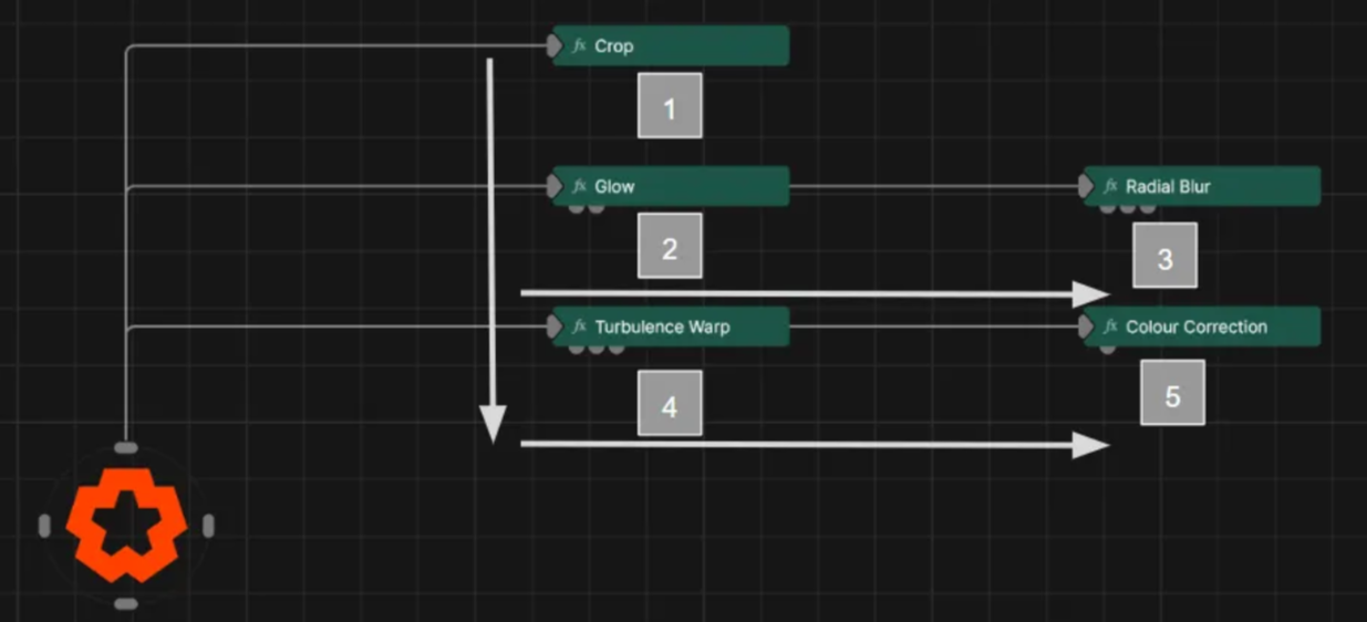

Order of Operations #
Where nodes share the same parent, the order of operations (the order in which the code for each node is executed) is determined by the nodes position on the nodegraph.
It is important to understand this behaviour as there are cases where the order of operations will dramatically change the overall outcome. Take for example a chain of Post-FX nodes: Applying a correction colour before a threshold will produce a different result than using the two nodes in reverse order.
The order of operations works from, top to bottom, left to right. This means that nodes that are higher in the nodegraph will be positioned before those positioned lower in the nodegraph.
If two nodes are at the same y position (i.e. at the same height) in the nodegraph, the order will be determined by their x position. In this case, the node on the left will be be processed first.
