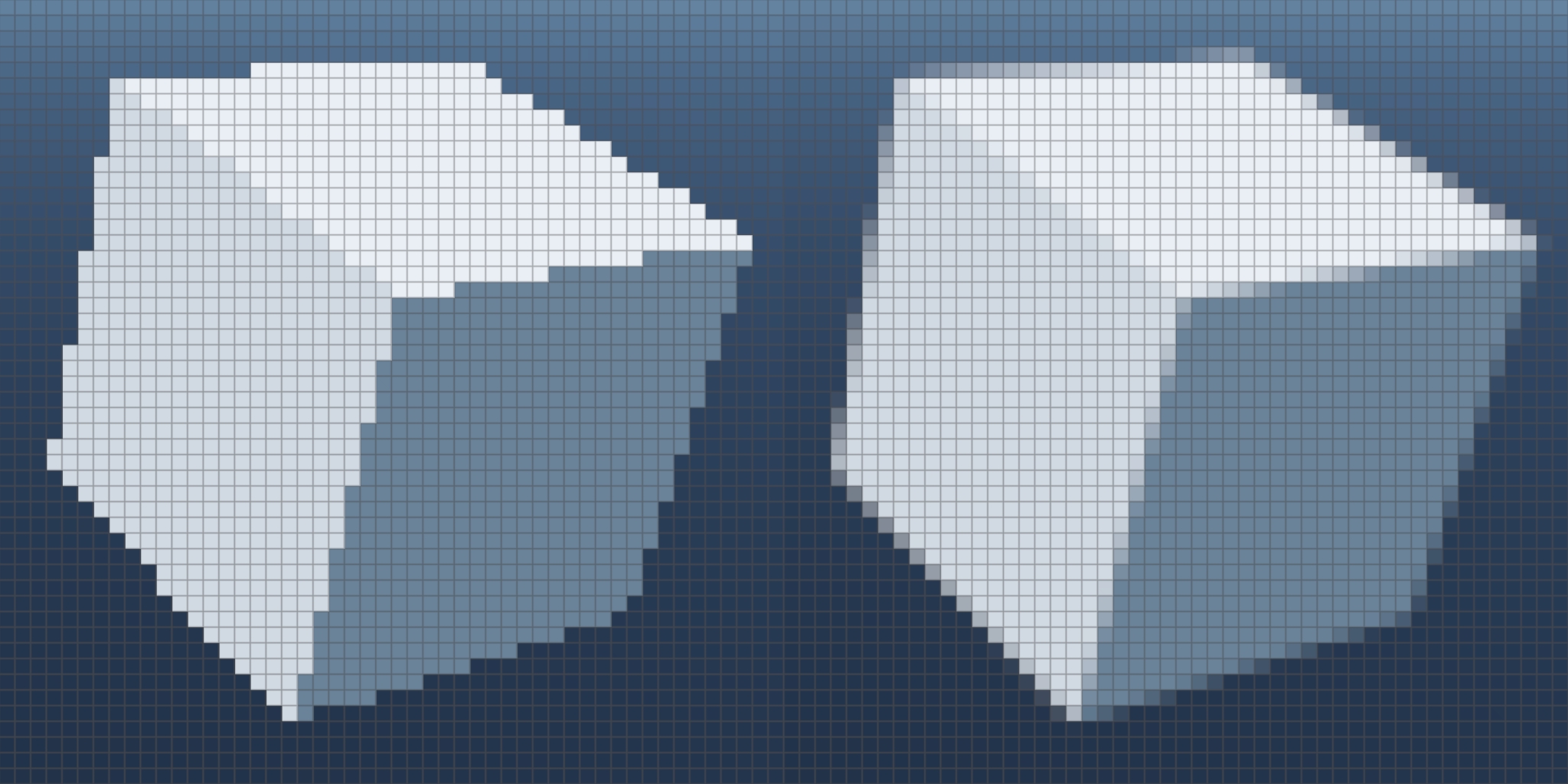

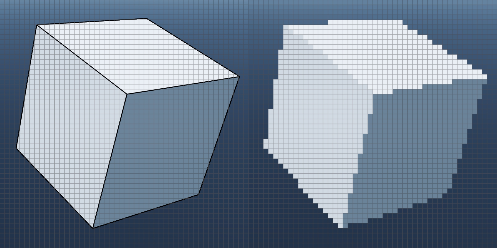

Take this simple example with no antialiasing applied and compare the shape drawn to the pixel grid below. When the object is rasterised, the pixels sample once at its centre to check if the line is touching. If the line overlaps with the pixel, it is treated as solid; otherwise, it is treated as empty. If the details are simple and spread over a large area, or the pixels are small and the eye can’t discern their differences, aliasing can be minor and ignored. However, on large canvases or under normal resolutions, aliasing can stand out as an artefact that must be addressed.

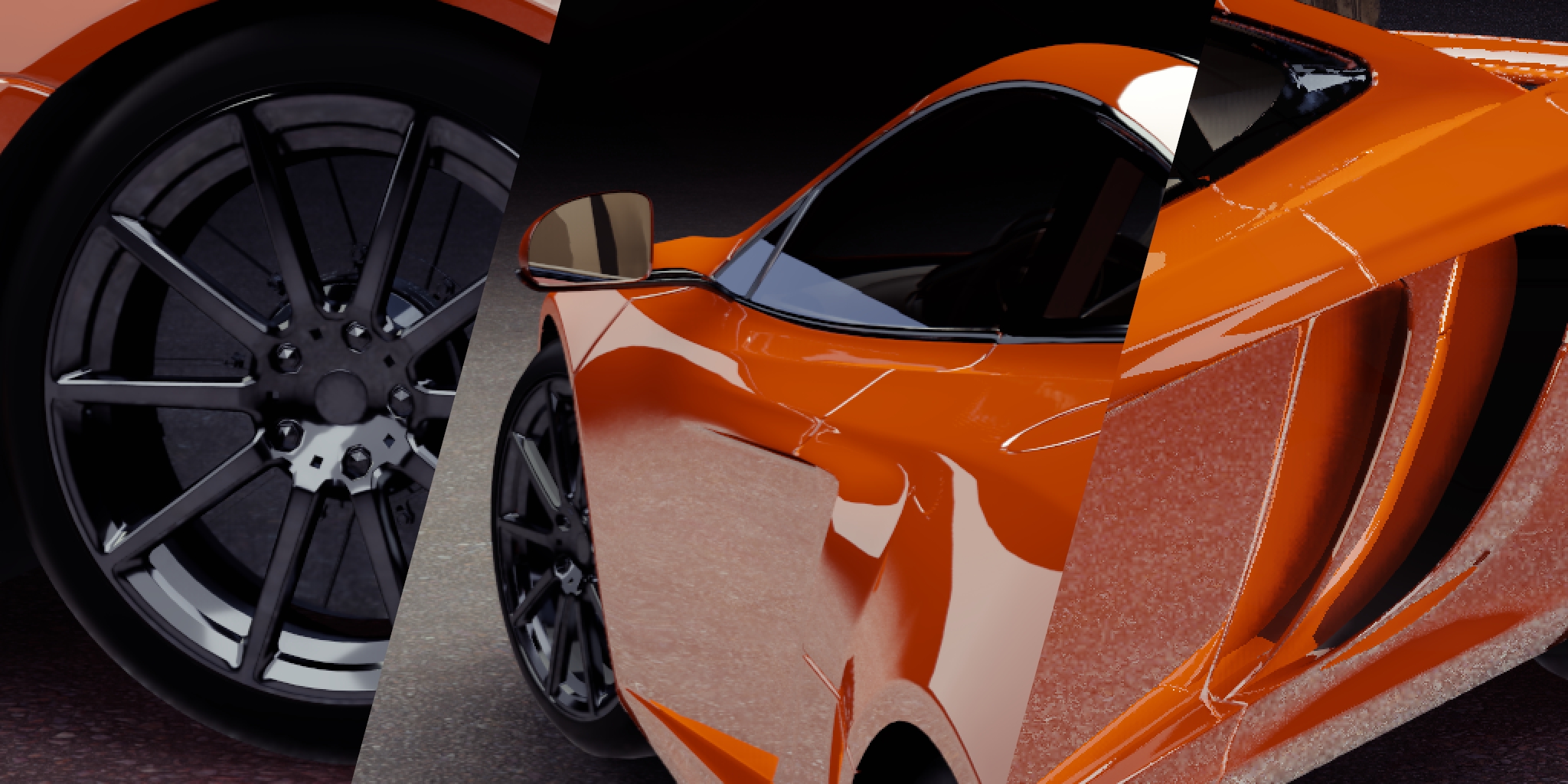

Samples geometry edges by identifying pixels hit by lines and edges of triangles and renders eight extra samples to reduce aliasing on geometry in the scene, but other pixels get just a single render. This solution works very well to anti-alias lines and the edges of triangles, one of the most obvious forms of aliasing in 3D renders, but has no effect on any other causes of aliasing.
Slows down the more geometry is visible on screen, and can impact VRAM usage.

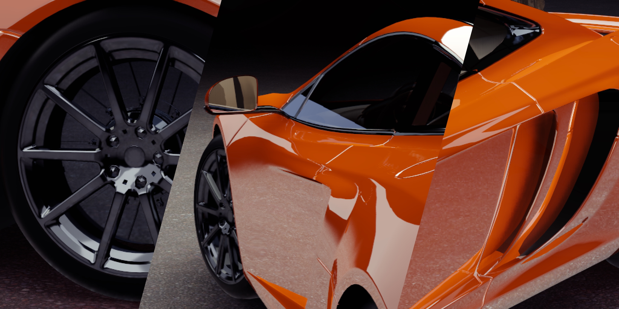

Resolve aliasing through Nvidias DLSS 2.0, a method based on machine learning which utilizes data from various Gbuffer passes to improve aliasing. Often works faster than MSAA, but can introduce Artefacts, such as Trailing object motion or smudgy after images with camera cuts. It is especially important with DLSS to make sure the motion vectors in the scene are generated correctly, as bad motion vectors can create artefacts.
DLSS also allows the user to set an internal resolution scaling. This can boost performance considerably in scenes where the rendering is the main cost, but can also introduce small aliasing artefacts as DLSS struggles to upscale the subpixel details.

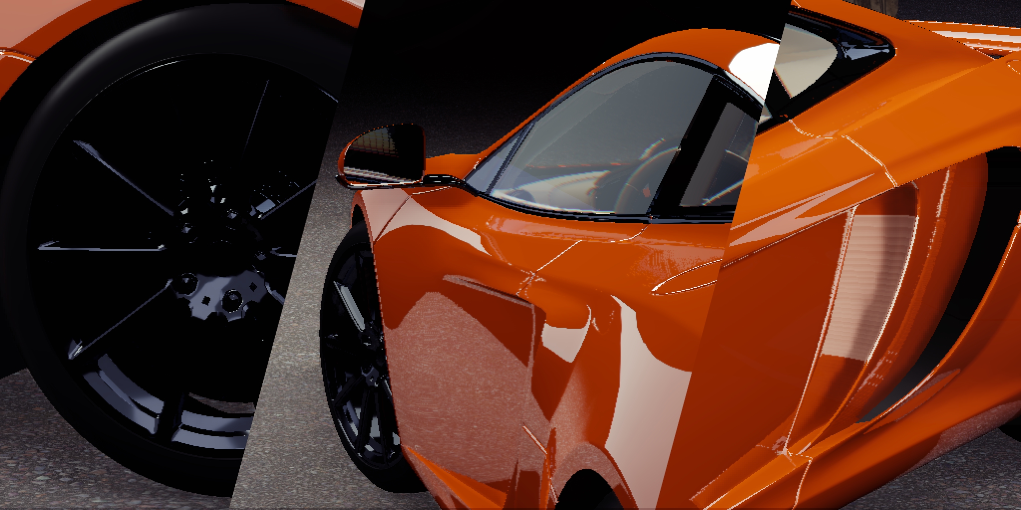

A subpixel jitter is applied to the camera to sample each pixel over time, referring to the motion vector pass to keep the visible jitter to a minimum but still generate an accurate result over time. For slow-moving scenes consisting of opaque/solid objects, it gives a great result for very little performance or memory cost and can solve all kinds of aliasing, particularly temporal flickers on geometry edges such as those caused by a slow-moving camera.
However, it only works properly for solid geometry. Transparent and alpha blended geometry can’t render motion vectors so can look inaccurate. Temporal Antialiasing is also prone to appearing blurry or jittery in some cases, and small trails can appear behind moving objects as the samples can take a few frames to converge to a clean image.
