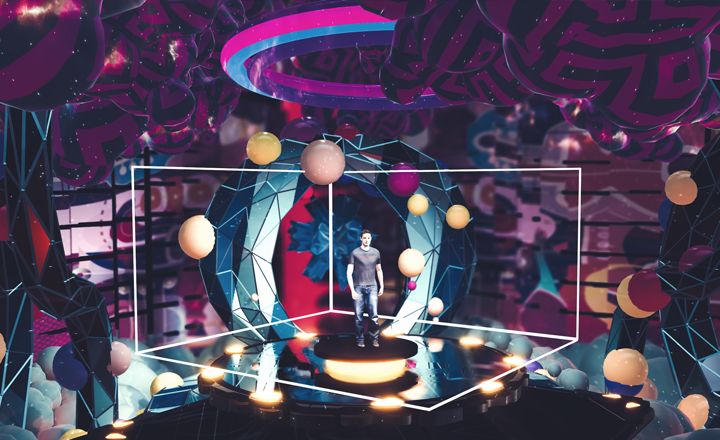

Stage Previsualisation #
When designing for either green screen or LED stage, it is a good idea to build a to-scale model of key items into your Notch project:
  • the LED stage/green screen wall
  • possibly the room/sound stage you are shooting in (see Location section)
  • any key physical props that may be on the stage
Parent these items to a Null or a Render Layer so that you can disable them when not previsualising.
After this, you can add your cameras (with appropriate FOVs).
Doing this will:
  • enable you to scale your virtual content correctly, as well as ensure that you are framing shots from positions the camera can reach
  • allow you to see the distance from the camera to subject and LED screen, to get a sense of the depth of field.
