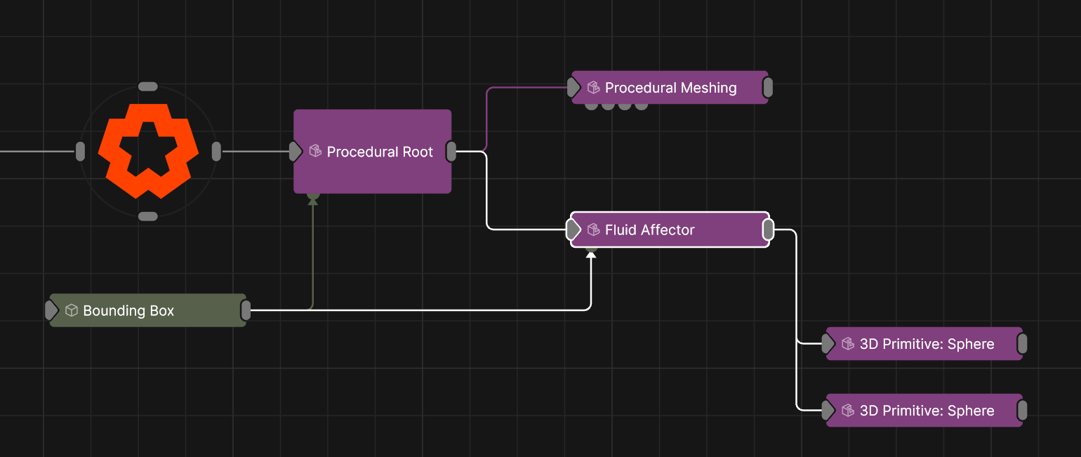

Apply a fluid deformation to a procedural.
This node applies a fluid simulation as a deformation on a procedural.
Fluid Simulation Speed The speed of the fluid simulation
Curl Noise Amount The amplitude of the noise pattern when using solver mode is set to curl noise
Noise Size The scale of the noise pattern when using solver mode is set to curl noise
Solver Mode The type of fluid simulation to perform.
  • Solver : This feature is in development.
  • Curl Noise : Uses an internal noise pattern to drive the fluid motion.
Grid Width The resolution of the solver’s simulation grid.
Grid Height The resolution of the solver’s simulation grid.
Grid Depth The resolution of the solver’s simulation grid.
Bounding BoxThe region within which to perform the fluid simulation.Bounding Box
