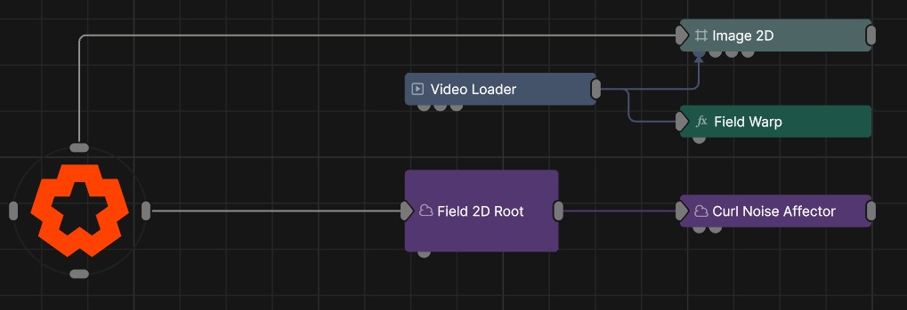

Warps an image based off of a field system.
This node warps an image based off of a field system.
The processed texture above has been altered from default to show the kind of effect you can get with this node. By default, no change will be made to the node until you input a field root system.
Amount How much the field root affects the image.
Inner Radius The inner radius of the warp.
Outer Radius The outer radius of the warp.
Use Velocities Toggle whether the velocities from the field node are used in the field warp.
Source FieldInput a field root node to affect the image.Field 2D Root
