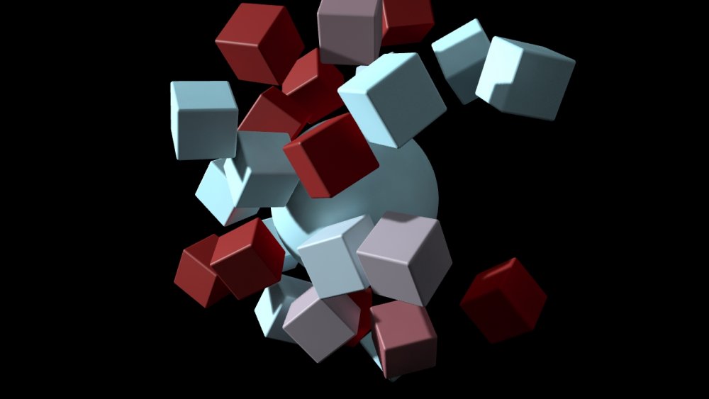

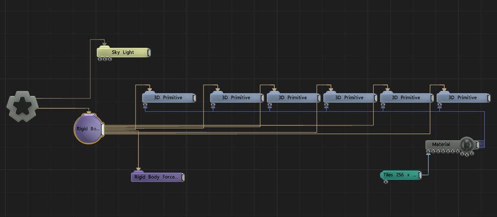

Allows forces to be applied to a physics objects.
This node applies a constant force on physics objects. This is typically used push and pull objects towards or away from the subject.
