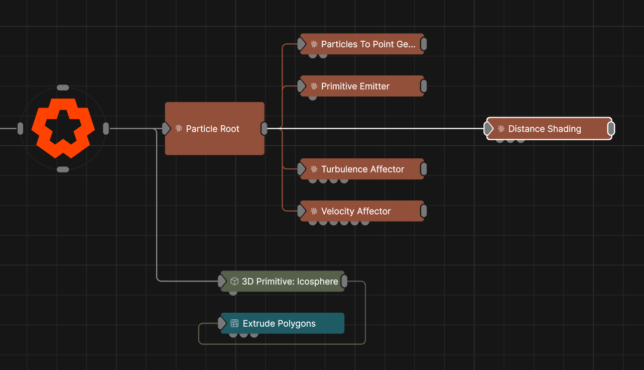

Shades particles based on their distance from a point.
This node shades particles based on their distance from a shape. The shape type is chosen using the Distance Mode parameter. Distance from the chosen shape is then calculated and a falloff function is used to produce a value that is used for shading. The distance calculation may be inverted so that the shading result is greater when further away from the shape.
