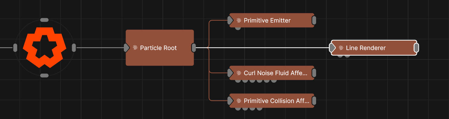

Renders lines between pairs of particles.
This node renders lines between particles and other points, which can be other particles or a set position in space.
Texture Select a texture to be rendered at each particles position.
Line Thickness Edit the thickness of the line rendered. Only functions if Use Thick Lines is turned on.
Line Origin Where each line is drawn from.
  • Random Particles : Pick a random particle to start the line from.
  • Null : All lines with start at the position of the Null connected to the “Line Origin” input.
  • Emission Sequence : Connect lines based on when the particles are emitted.
Particle Alpha Change the alpha value for the particles.
Depth Of Field Amount How much depth of field effects the particles.
Screen Size Limits The minimum and maximum size of the rendered particle in normalised screen coordiates.
Sort Key Value Biases the depth-based render order, to force the particle system to be drawn before or after other objects in the scene.
Lit Control whether the particles are lit.
Cast Shadows Control whether shadows are cast.
Blend Mode Edit the blend mode used for the particles. See Blend Modes for details.
Use Thick Lines Toggle whether the lines have 3D thickness, or not.
Line OriginOrigin of the lines when “Line Origin” is set to “Null”.Null
