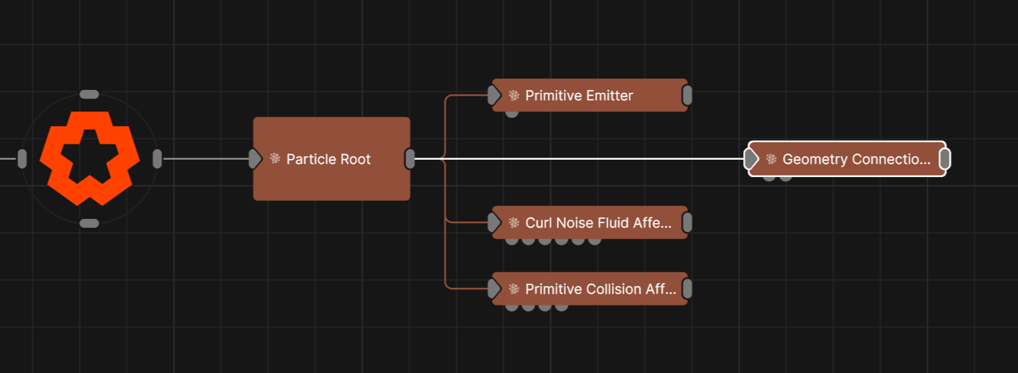

Renders particles as connected geometry and lines.
This node generates faces and lines based on the position of particles in the scene. Particles are joined with lines by proximity, and where lines form a triangle geometry is created.
You can deform the generated geometry with Deformer Nodes.
Visible Control whether the node is visible in the scene or not.
Seen By Rays Allow the node to be seen by the raytracer. When set to 0, the node will still render in camera but will be ignored by any raytracing nodes.
Min Distance Threshold Minimum distance between two particles to draw a line between.
Distance Threshold Maximum distance a line can be drawn at.
Connection Lifetime How long a line drawn between two particles should last after the connection is initially made.
Draw Triangles Draw triangle geometry from the particles.
Use Particle Colours Recolour the triangles to blend between the colour of the particles they were spawned from.
MaterialAdd a material to override the internal material and affect the generated geometry.Material
