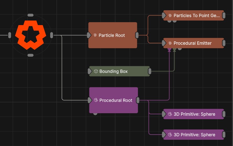

Emit particles from a Procedural system.
This node is used to emit particles from a Procedural system, using the Signed Distance Field to indicate where to emit the particles and modulate their alpha.

Procedural RootConnect a source procedural node.Procedural Root
Bounding BoxLimits the area that the procedural emitter will use.Bounding Box
