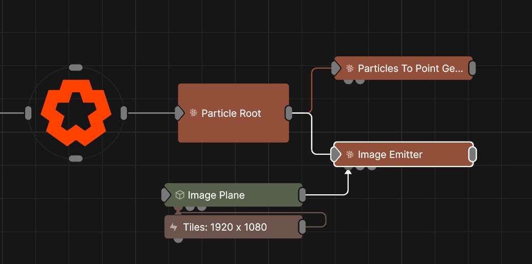

This node emits particles from an image or video, using the RGBA channels to control the image emission. Motion vectors can also be used to make particles track the motion of a video once emitted, through the connection of an Optical Flow node. The image or video may be set directly using the Image attribute, or taken from a node connected via the Video Node attribute.
The location of emitted particles depends on the way the image is supplied to the emitter. If an image is supplied via the Image attribute or linked from a Video node it will be emitted from a unit plane in the XY axis, combined with the transform from the emitter itself. If an Image Plane node is linked to the emitter’s Video Node input the transform from the Image Plane is used, so the particles will emit at the same location in 3D space as the pixels in the Image Plane, assuming the emitter’s own transform doesn’t offset it.
Requires an image to be supplied via the Image property or the Video Node input to function.
