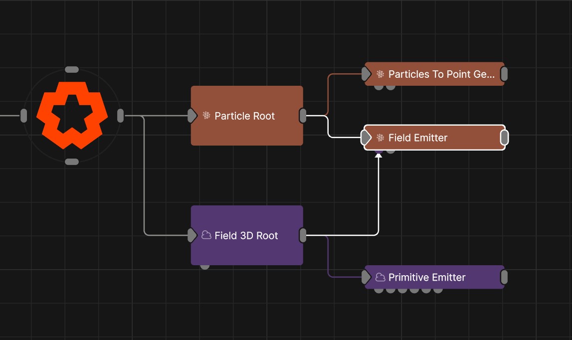

Emit particles from a Field system.
Updated: 11 Nov 2025
This node emits particles from an input Field system, using the Colours, Density, or Temperatures passed through from the Field. The resultant particles can then pick up the location and velocities to flow along with the field, adding extra details and motion to an existing field or creating accurate fluid motion.

| Field Source | Field used as a basis for the particle system. | Field 3D Root |
| Colour Control Nodes | Control the colours of the particles on emission. | Colour Ramp |
