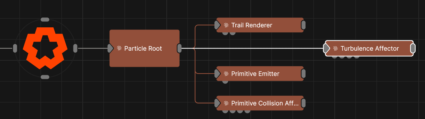

Applies turbulence to particles.
This node applies turbulence to the particle motion. This is typically used to apply local variations to particle movement and simulate small gusts of wind. The motion is generated by using a smoothed noise field for both the direction and the magnitude of the applied velocity.
Inner Radius Alter the inner radius up to which the affector is fully effective.
Noise Scale The scale of the noise field.
Noise Threshold The threshold applied to the noise field.
Mode Change which kind of turbulence is applied.
  • Attract : Attract The particles move towards the node.
  • Directional Force : The force is applied in a direction defined by the rotation of the node.
  • Repel : The particles move away from the node.
  • Turbulence : The particles are given turbulent motion.
Falloff Shape The affect becomes weaker the further away from a chosen shape.
Velocity NodeOverrides the velocity direction.Null
