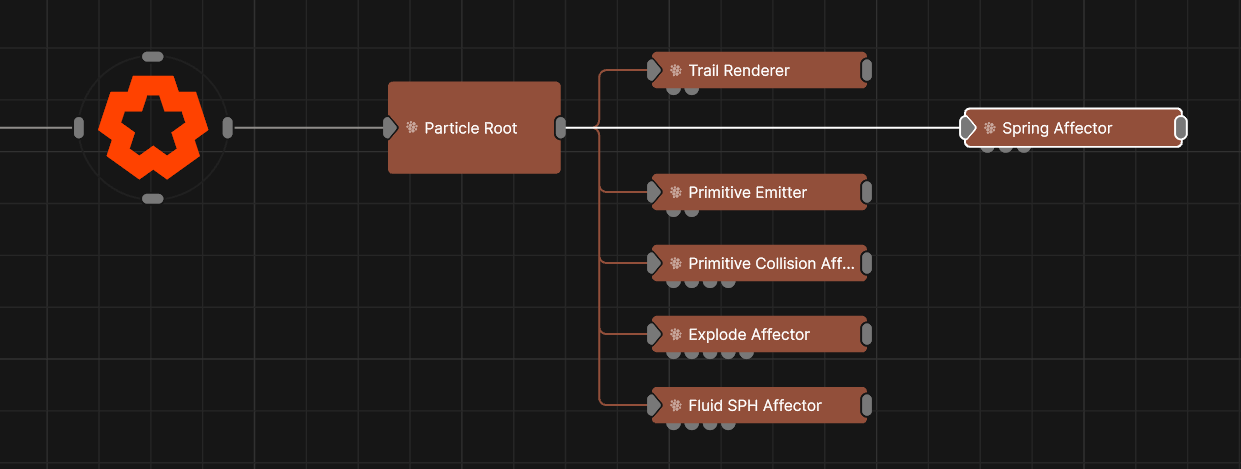

Spring Affector
Updated: 15 Dec 2025
Applies a spring simulation on particles.
This node simulates a spring-like effect between a particle’s current position and its original emission position, making it spring back towards the point it was emitted from over a period of time. This can be used to restore particles to their original emitted form, or as part of cloth simulations.
| Parameter | Details |
| Spring Length | The scaling applied to the rest length of the generated springs. |
| Spring Strength | The strength of the spring effect. Larger values will make spring forces greater and particles will move more quickly. |
| Spring Dampening | The dampening applied to the spring forces. |
