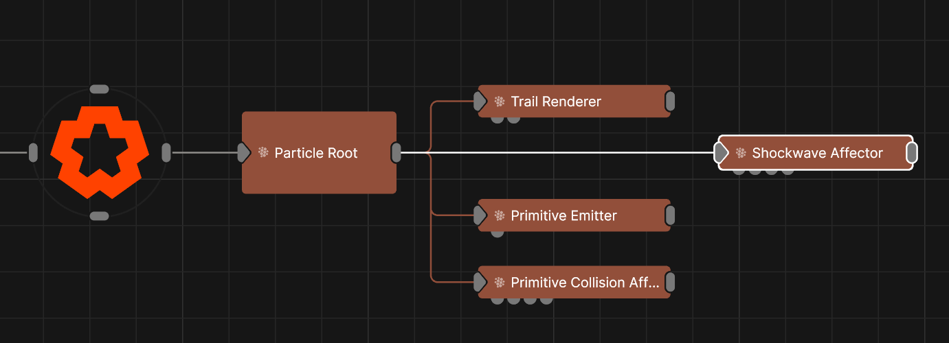

Shockwave Affector
Updated: 15 Dec 2025
Apply a shockwave through particles.
This node applies a pulsing spatial shockwave through particles. The shockwave moves outward from the emission point, and pushes and pulls the particles it comes in contact with.
