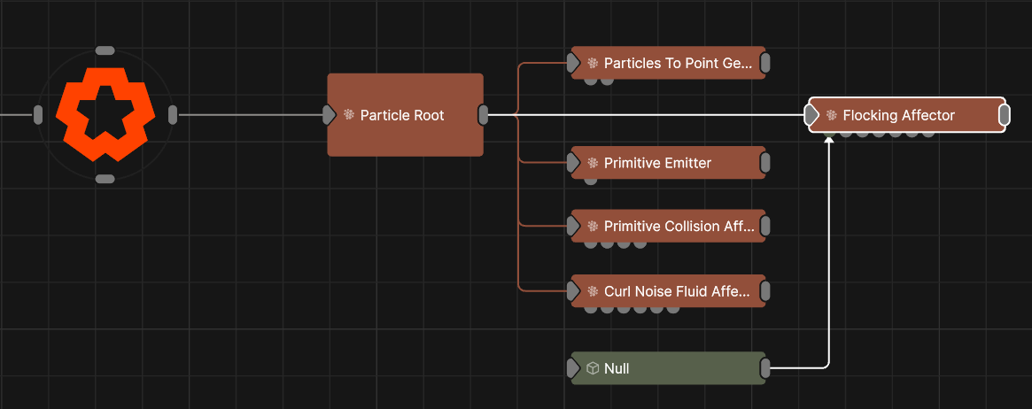

This node simulates a flocking behaviour on a particle system. This is typically used to make particles behave like a flock of birds or a shoal of fish.
The simulation solves several different behaviour goals: making particles move towards their goal position (goal seeking); making particles avoid others nearby (avoidance); making particles stay close to their neighbours (cohesion); and making particles move in the same direction as their neighbours (alignment). The results of these conflicting goals are weighted together to produce a new velocity for the particle. The weights for the different behaviour goals are summed together and normalised, so a large weighting on one behaviour reduces the effect of the others.
The goal positions are determined by connecting nodes to the Flock Goal Nodes input. Where 3D objects are used, vertex positions are used as goals, Otherwise the transform position of the connected node is used. Where there are multiple goals, particles are each assigned a goal either randomly or based on their emitter.
The range in which particles can see their neighbours is determined by radii - Cohesion Radius and Avoidance Radius. The neighbourhood search is achieved internally by placing particles into a grid, and the location, cell size and resolution of this grid may be controlled in order to optimise the performance requirements of the node. Larger search areas, and search areas containing more particles, increase demands on performance. Larger grid resolutions may be desirable when dealing with large areas of space.
