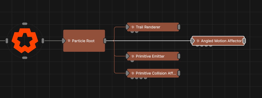

Moves particles via a noise field, with directions that are constrained to an angle.
This node moves particles via a noise field, with directions that are constrained to an angle - allowing for example motions constrained to square patterns.
