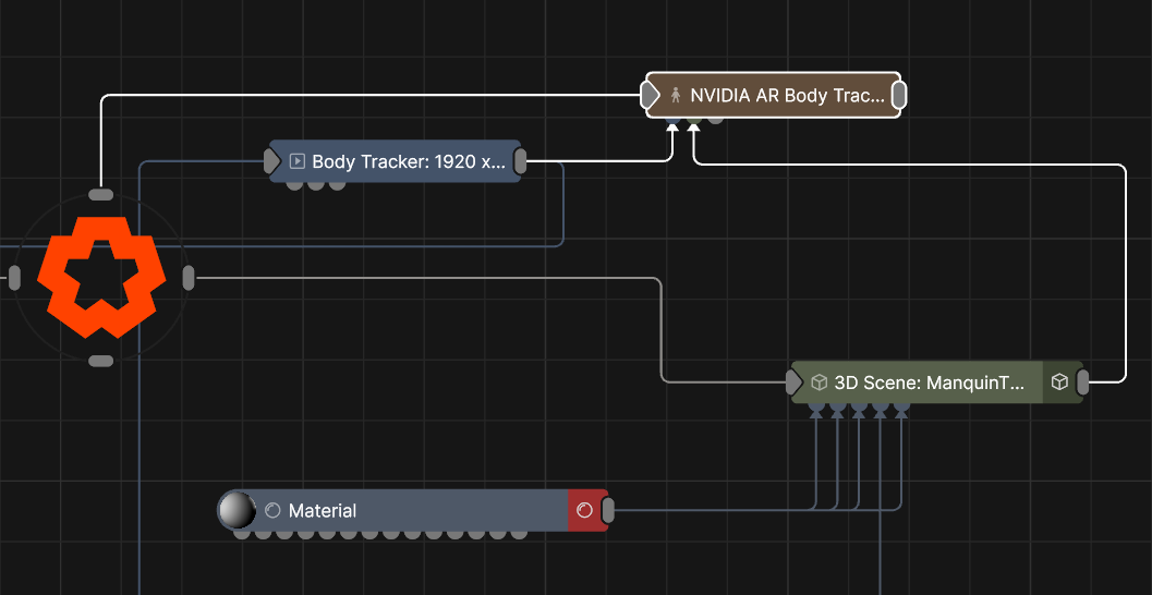

This node applies the tracked skeleton from the NVIDIA AR Body Tracker to the skeleton of a connected rigged character.
This node requires the installation of the NVIDIA AR SDK, which can be downloaded here : NVIDIA AR SDK. Make sure you get the correct driver for your GPU, Turing (20XX), Ampere (30XX) and Ada (40XX) use different drivers and they are not cross compatible.
For best results, use a character with a rig generated from Mixamo. Other skeletons can be used, but results may vary.

| NVIDIA AR Body Tracker | Required body tracker input, for generating a tracked skeleton | NVIDIA AR Body Tracker |
| Hierarchy Root | Connect the skeleton root node to drive the rest of the skeleton from. | 3D Scene |
